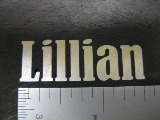

I built a benchtop CNC machine recently. This is a very rigid aluminum frame, THK SR15 rigid rails, rolled ballscrews, preloaded (no backlash) ballnuts, etc - so probably considered a "mid-range" DIY unit.
I'm running a PC890, with exactly .001" of total runout 1" from the end of the chuck (dial indicator on 1/4" precision ground rod). So, the amount of runout on a 1/32" cutter, .300" from the bottom of the chuck is pretty minimal. Less than .0001". Over time this will only get worse, but a great starting point. I just cut some pearl and the results were outstanding.
Paul, there are some amazingly high tolerance small CNC machines available. Your observation may apply to general purpose woodworking machines, but with CNC, often the smaller the machine, the more important the accuracy. It all depends on what they are designed to do. If the machine is well designed, your spindle is fast & solid, and you choose correct tooling and feedrates you will see good results - just like everyone has commented.
This was cut yesterday. My 8 month old daughters name, in letters .5" tall. 1/32" carbide upcut. .060" gold MOP. (4) .015" passes at 5/3 ipm (faster in ebony). I undersized the MOP by .001" on the perimeter and got a *perfect* slip fit. This is just pressed in, unglued and unsanded.
